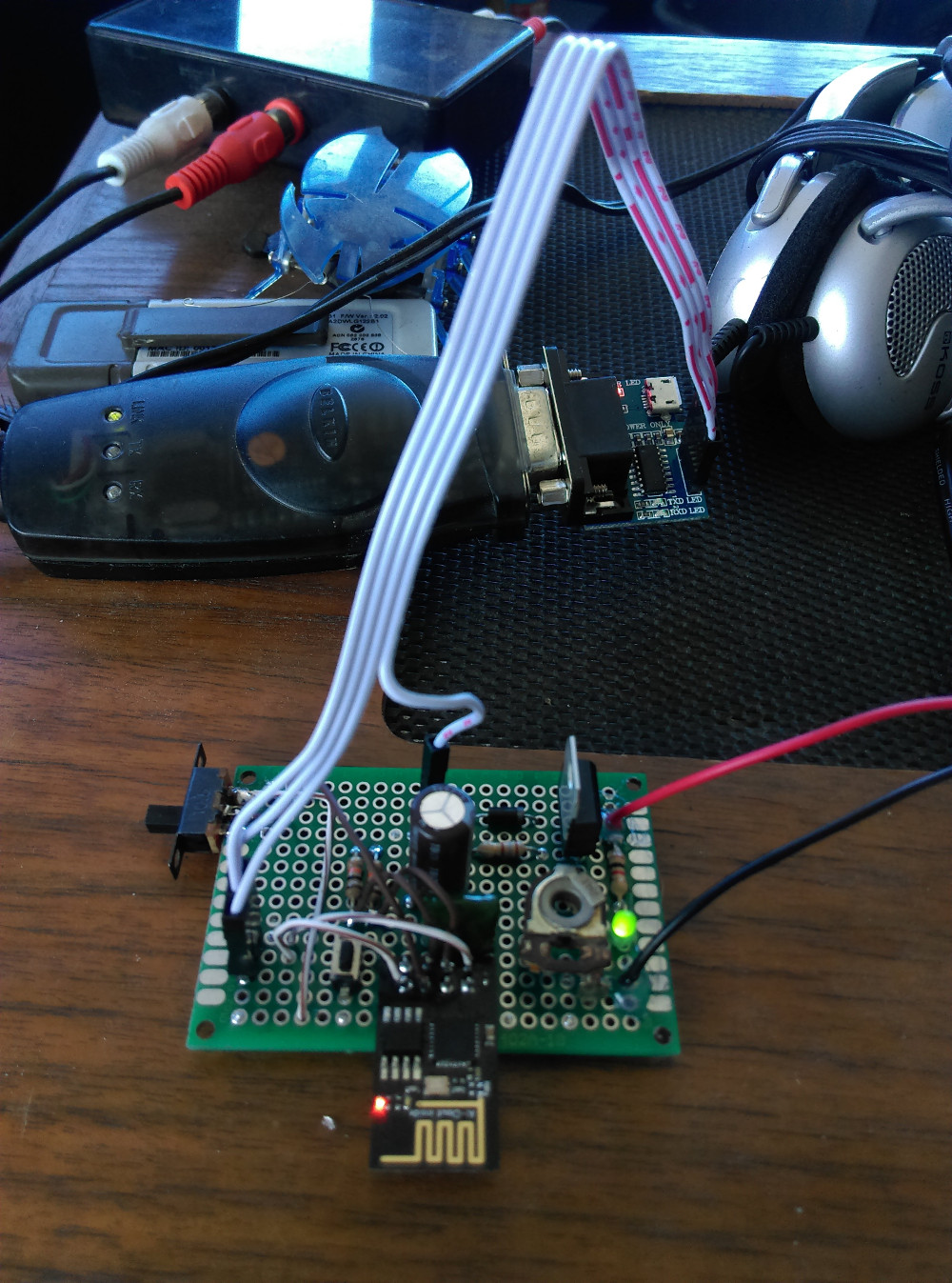

This time, I wanted to ensure everything was correct - so I purchased a true hardware-based RS232-to-ttl adapter (plugs into the end of the Belkin) and lets you select 5/3.3v.
Hooked the Belkin up to the TTL adapter, TTL adapter to the ESP8266, and the TTL adapter and ESP8266 both up to a very good 3.3v power supply (using an LM317).
Thing worked like a champ. I scanned and joined my WiFi network, did a couple manual test TCP connections (all using AT commands over Arduino serial console connected directly to ESP8266 via the Belkin).

Using the same command as last time (esptool) but using the RS232-to-ttl adapter (vs my home-made resistor network)... the flash went just fine. Esptool completes the flash without issue. But since then, I have NEVER ONCE been able to communicate with the board since.
Basically, all I get now is kinda like the first chip started: garbage output on reset.. nothing after that. When the reset button is presset (or unit is initially powered on), I get garbled output (I assume would be the "AI thinker - ready" prompt) - and after that... nothing. Typing commands does not return anything. I have tried all baud rates. The same.
