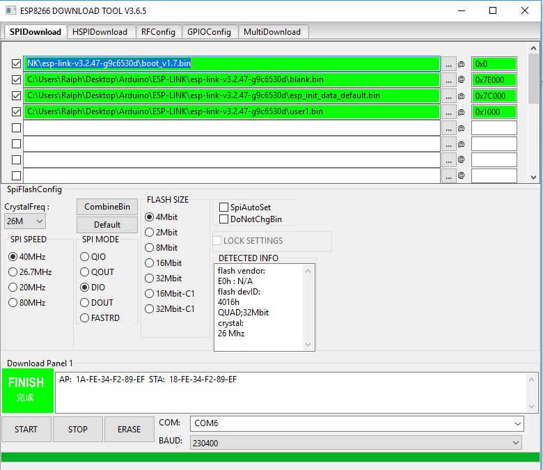

I duly plugged it into a usb port on my windows box and looked at some tutorials to get it going

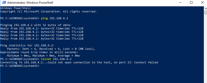

I seem to have it responding etc. I can connect to it over wifi ok and can ping it at 192.168.4.1 etc.
I just can't open port 23 over telnet on it so can't communicate over it
Any ideas

This is the debug log after boot
123> ** esp-link v3.2.47-g9c6530d
123> Flash config restore ok
123> CONN led=0
123> SER led=2
124> Wifi init, mode=AP
124> Wifi uses DHCP, hostname=esp-link
124> "ip": "0.0.0.0"
124> "netmask": "0.0.0.0"
124> "gateway": "0.0.0.0"
124> "hostname": "<null>"
124> sleep enable,type: 2
125> Httpd init, conn=0x3fff4128
125> No user file system found!
125> Serbridge pins: reset=1 isp=3 tx_enable=-1 swap=1
126> Reset cause: 4=restart
126> exccause=0 epc1=0x0 epc2=0x0 epc3=0x0 excvaddr=0x0 depc=0x0
126> Flash map 512KB:256/256, manuf 0xE0 chip 0x4016
126> ** esp-link v3.2.47-g9c6530d: ready, heap=18960
127> SNTP timesource set to us.pool.ntp.org with offset 0
127> initializing user application
127> Waiting for work to do...
127> mode : softAP(1a:fe:34:f2:89:ef)
128> add if1
128> dhcp server start:(ip:192.168.4.1,mask:255.255.255.0,gw:192.168.4.1)
130> bcn 100
7471> add 1
7471> aid 1
7471> station: e8:2a:ea:5a:d8:90 join, AID = 1
7472> Wifi AP: station e8:2a:ea:5a:d8:90 joined, AID = 1
