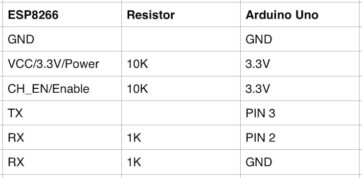

Edit: Between my posting this and the mods approving it, I also tried this tutorial, https://www.hackster.io/jeffpar0721/add-wifi-to-arduino-uno-663b9e. It is just the wiring that is different:
I have the same exact results with both wiring: At commands seem to never be answered. I don't get any "OK" from the ESP8266
