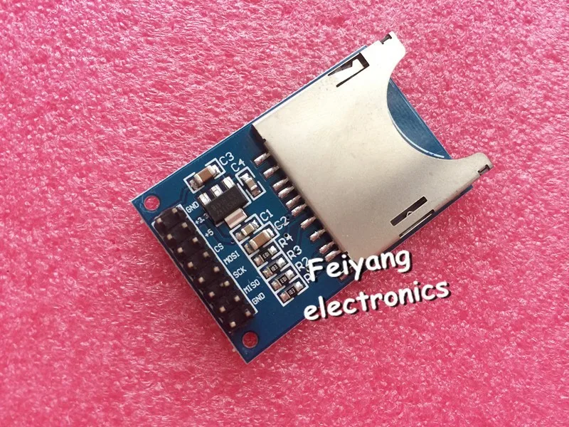

I have:
ESP8266 NodeMCU
And the SD Card reader:
It looks like the ESP8266 board is not supported by the library, but I was looking at google for some other way to accesss SD card from ESP8266 and didn't find any other way than using the SD library.
Any ideas?
