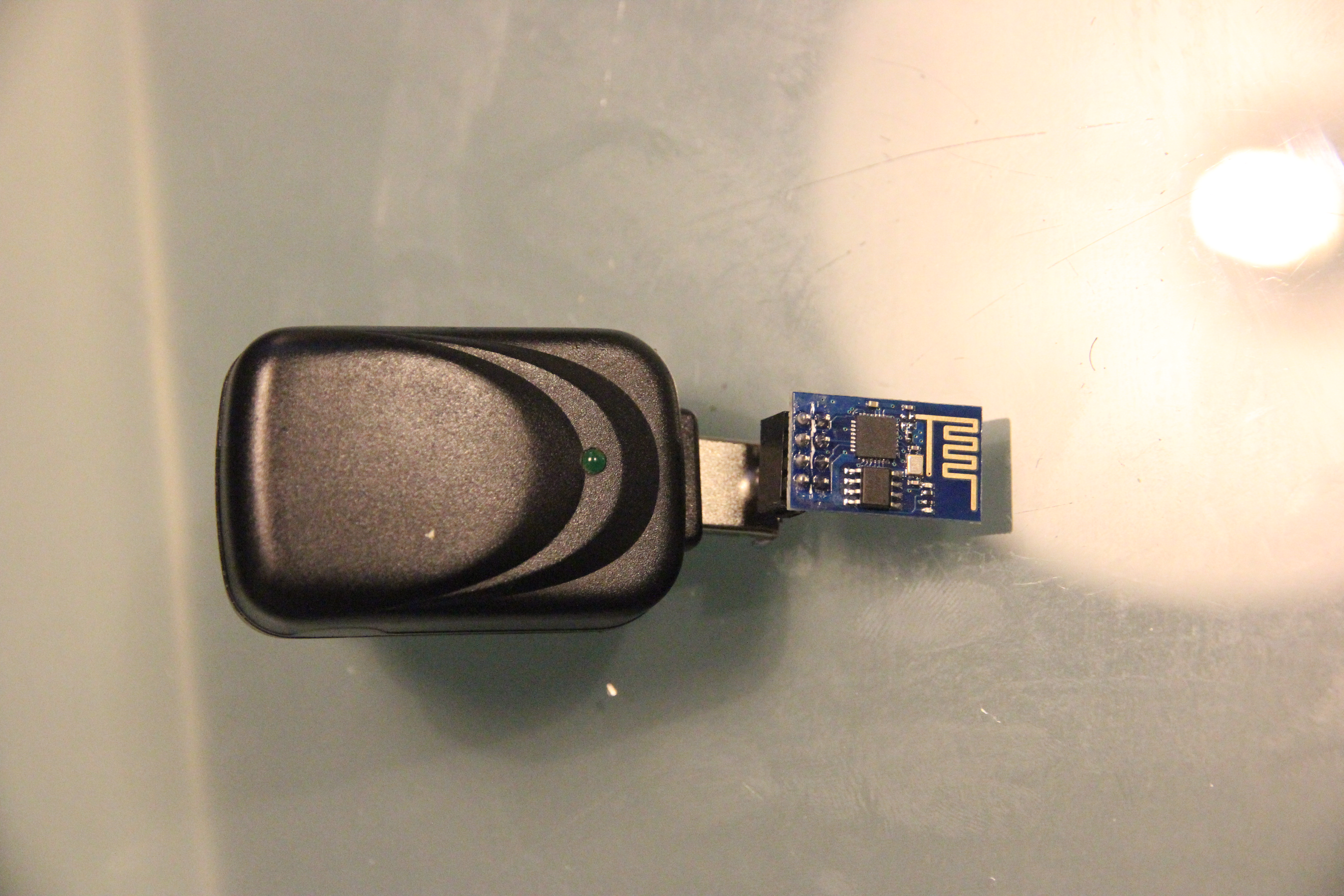

Anyway, that's still pretty good if you consider that the bot is completely in the style of the channel:
That's a 5V USB power plug which feeds into a LM1117-3.3 which powers the ESP8266. The only extra component is an 100uF cap to suppress transient spikes.
I'll publish sources as soon as I cleaned them up a bit.
